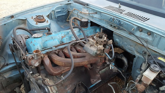

Nother Update:
Okay today, did some trimming in the trans tunnel nothing that opened it at all. Just cut off the toyo kogyo trans mount brackets as they are of no use and in the way.
Also notched front cross member so engine will sit 1 inch lower and better clearance. It's quite stout so no harm done a piece of plate will be welded on to close the notch.
The A833 fits in, the top shift lever is a tight one and the shifter mount will require a small incision along the trans tunnel near the factory shifter hole. Its tight but will not impede my legs at all but there is not much real estate in this car.
Not a job for the squeamish its hot and dirty the cross member was not that easy to cut either.
Nect step is to install complete engine with trans, align and set it as per clearance and correct pinion angle. Im considering off setting it by 1 inch to the right this woukd help my shifter and rods as well as the huge throwout fork which I wiill customize to work with an aftermarket slave cylinder.
Fabricate all mounts weld etc.
Then all the sheetmetal work to close all of my incisions..

for better or worse, the Slant 6 and A833 are installed in the Road Kill 79 RX slant 6 special, Freiberger and Finnegan would be proud or falling down laughing.
Okay some hurdles, big ones too, shifter is gonna require some cutting on 1 side of the tunnel, the clutch release bearing fork pedal will be interesting.
Barring these obstacles, could swap out 833 for a A904, bridges to cross, this old rust bucket needs some welding for sure.
If it all fails, Ive got no money involved, well very little, some time and maybe some hurt feelings if it all fails.Stay tuned
