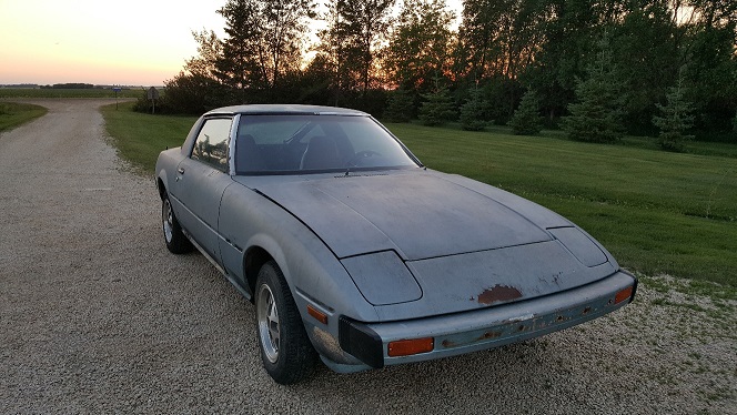

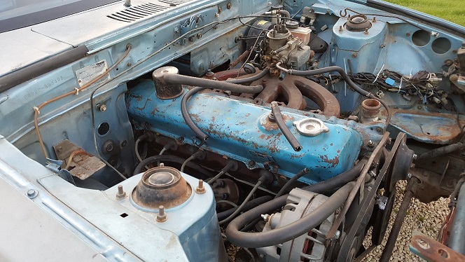

for better or worse, the Slant 6 and A833 are installed in the Road Kill 79 RX slant 6 special, Freiberger and Finnegan would be proud or falling down laughing.
Okay some hurdles, big ones too, shifter is gonna require some cutting on 1 side of the tunnel, the clutch release bearing fork pedal will be interesting.
Barring these obstacles, could swap out 833 for a A904, bridges to cross, this old rust bucket needs some welding for sure.
If it all fails, Ive got no money involved, well very little, some time and maybe some hurt feelings if it all fails.Stay tuned

PostPosted: Fri Jul 13, 2018 4:43 am
Posts: 9165
Very nice progress. Thanks for sharing! My brother has had a first gen RX7 sitting in his yard in Tucson for 25 years with some wiring issues. I’ve often thought of dropping a Slant in there. Maybe I’ll ask him about it... in another few years...
I can’t wait to see yours running. At your pace that will be soon. :wink:

Wacky and pointless way to ruin a classic RX-7. I love it! You really work fast. I can't wait to see it running.

With the gear ratios available for the RX-7 you will really want to keep the overdrive. Unless your goals are met 1/8-mile at a time. :D
