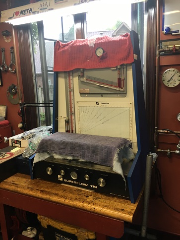

A follow up to the port flow stuff I have done since I got Mike's flow bench.
There are times when I think I would be much further along on the 68 Barracuda If I had not gotten that bench, as I have invested some time into it, but I have learned much and this is what I know.
The flow bench still calibrates to the to the manual requirements, which is a good thing. I have made a couple of improvements to the bench to reduce test variability.
I added dowels to the top plate that locate off two of the head bolt holes, that gets the combustion chamber centered to the test pipe the same way every time.
Mike used a set of large vise grips to clamp the head to the top plate, there was always some leakage that would need to be accounted for in the test results.
I drilled the top plate to allow the use of the four head bolts around the chamber being tested to clamp the head. That has taken the test leakage value to zero.

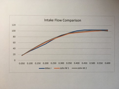

The charts below are of back to back test results ran last week of one intake port from the cracked MJ head and for two of the intake ports on the head that I ported duplicating what I found on the MJ ported head and describe above. The Exhaust test is one MJ port and one of my ports.
Keep in mind that this test bench tests at 10 inches of pressure, the over all results will be lower than a head tested at 20 or 26 inches. Testing a V8 head with large ports I bet this bench would run out of capacity at the higher lifts, but it still has test pressure capacity at high lifts on these slant heads.
You can see on the charts that ports I cut slightly out flow the MJ ports at lower lifts then it swaps with the MJ head flowing more at higher lifts. I don't know definitely as I have not tested this but visually Mike ran very narrow seats and as a result of that is the ID of the valve bowl at the seat is slightly larger. My though is that at large lifts the larger diameter will move more air. At lower lifts the larger diameter looses some velocity and the flow is less.

One thing this has done is clear up my confusion about some of the engine builds described here. I have seen builds listed as being in the 220 hp range yet the port flow numbers were quoted as being 199 cfm (if my memory is right- maybe I'm getting different builds confused). I would think a 199 cfm build could do 250+ hp.
Knowing that a well ported head flows about 105 cfm at 10" means it flows about 175 cfm at 28" - this is more in line with the ~220 hp number.
I saw an image years ago on this forum that had several heads shown in the 190-200 range. I wonder if this was accomplished by completely eliminating the valve guide boss, or if some of those numbers are the result of an improper flow conversion.
PostPosted: Tue Nov 12, 2019 6:19 am
Posts: 3857
actually I think that port flow benches are a bit like engine dynamometers, they may repeat back to them self, but when you try to compare the test results from one machine to the test results from another machine, it gets a little fuzzy.
here is a post from a guy that says he gets a slant intake to flow 200+ (guess that is at 28 inches) by only working the floor and a little on the sides. (see post #26)
https://www.forabodiesonly.com/mopar/th ... ng.433131/
so like all things, it is likely there more than one way to do it.
Gary Bruner told me this one time and I do believe it, anything that helps you see the backside of the valve, when looking through the manifold face is going to help flow.
