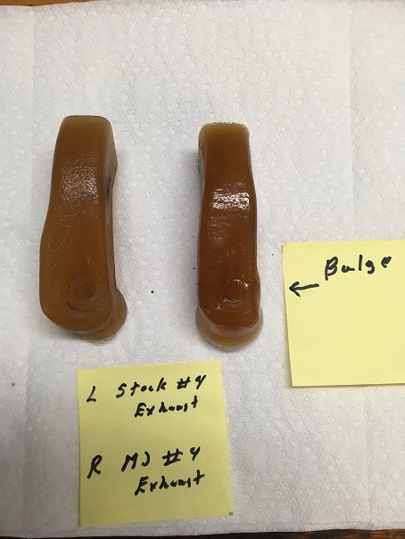

photos of the exhaust molds
on the exhaust molds one can see the bowl sizing to match the seat diameter and the
general slickness of the MJ molds dues to the walls being smoothed.
As I mentioned earlier the major geometry of the port arms was not changed
the one thing that is shown in the exhaust mold is the slight bulge at the side of the
bowl. I attempted to duplicate that, but I did not test with and without.
When I get the head I am working currently completely finished I will make port molds
and see how they actually compare to the MJ molds that I have on hand.
This would all be so much quicker with a 3D scanning / layout device, but there are times when you
do with what you have.
