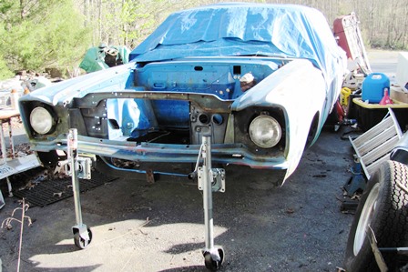

I pulled the front fenders off and stripped all the remaining items from the engine compartment in prep for paint. The engine compartment is in much better shape than I thought. Just needs primer and paint.
It seems that AMD has discontinued floor pans for the 65 Belvedere so I bought one of the last ones they had. The current floor is a bunch of metal patches (some very poorly installed). I figured I may as well install it now and be done with it. I cut the old floor out, just need to trim up the edges and set the new floor into place. Maybe now, the carpet will finally lay flat.
