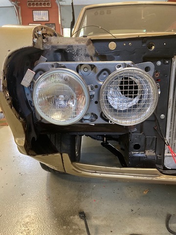

Mounted the GlasTek hood. Used a set of low tension springs from a FABO seller. The springs are a perfect fit to the weight of the hood. I am pleased with how well this has gone. I have a hood pin set and will install those after the final panel alignment.
https://www.forabodiesonly.com/mopar/th ... 1973177598
I have also fine tuned the revised front end look and functional alignment. I am going after the 69 Charger 500 flush head light appearance. I will retain the split grill of the 2nd generation Barracuda, with one of my goals being that the changes allow the OE grills to be re installed

I see the look that you're going for, with the split grill it looks like maybe a 3/4 scale version of my kid's 72 fury with the hideaway headlite doors open
Now if y could engineer in the hideaways that would be something......... Just an idea.
Oh yeah the 68/9 chargers (other than the "500"s) had em too
