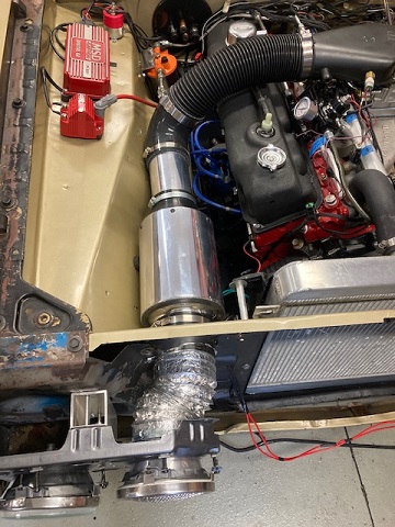

Today finished the cold air intake.
I have gone through several cold and hot starts on the new engine and have started doing the MS3 tuning process. Its all still good.
The motor fires good, no leaks. The AF - VE responses to setting changes are predictable.
Looking forward to 2021.

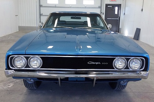

Mounted the GlasTek hood. Used a set of low tension springs from a FABO seller. The springs are a perfect fit to the weight of the hood. I am pleased with how well this has gone. I have a hood pin set and will install those after the final panel alignment.
https://www.forabodiesonly.com/mopar/th ... 1973177598
I have also fine tuned the revised front end look and functional alignment. I am going after the 69 Charger 500 flush head light appearance. I will retain the split grill of the 2nd generation Barracuda, with one of my goals being that the changes allow the OE grills to be re installed
