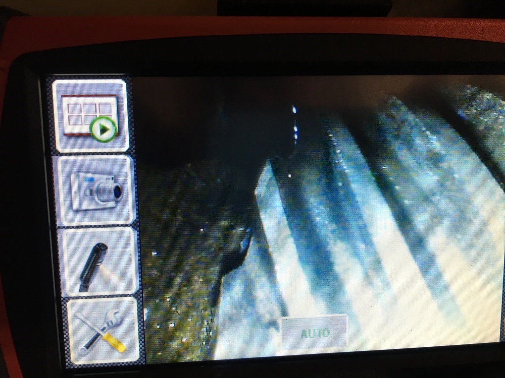

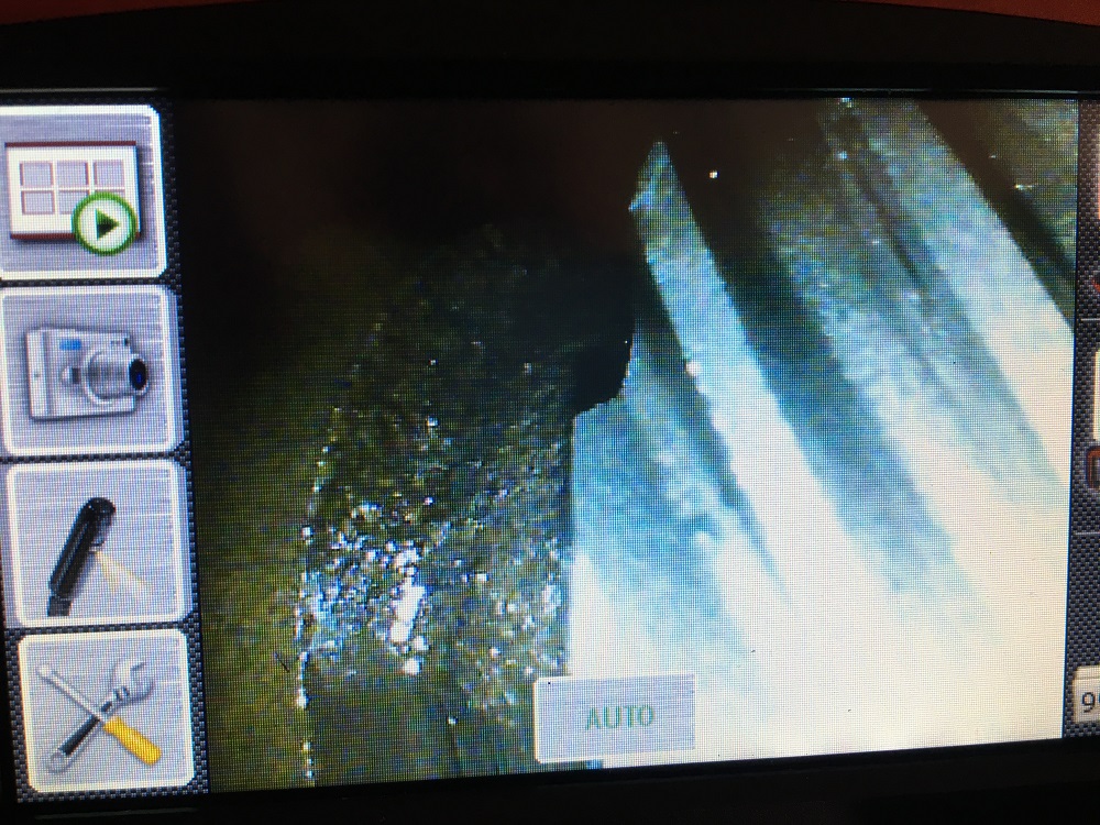

I did use the scope today to try and get a better look at the cam. As always(for me) looking into a hole with bad eyes with poor lighting options and limited room makes for a bad combination. On top of that, these are pictures of the scopes screen. I could not figure out how to get it to take a picture.
I know these are not good but it did look to me that the wear on the gear was not terrible. Although none would be better I could not see anything that will keep me from running the cam. I got a good Dutra pump with the extra spray tube and a very nice well used gear. I already assembled it and will probably try and get it back together and running Monday. Once it is back up and running I should be able to tell if the whine is gone.
The wear I could see did not appear to be in the middle of the cam gear.
It also appeared to be up higher on the tooth. ( To the outside)
Doug just let me know if you want the pump sent back and to where. I know you have a lot going on so you take your time. It can set here as long as need be.
PostPosted: Sun Dec 27, 2020 5:11 pm
Posts: 3740
Location: Sonoma, Calif.
Are you able to swap a gear if I send you a 13T factory one?
Re-running the test with a factory 13T gear on the same pump will give us some good info. on the pressure difference that 1 tooth makes.
