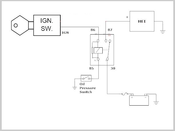

My ignition is configured with a relay as well. I have fused power switched on, via relay, to my HEI.
Fused power goes to the input relay (switched) contacts. The HEI power is connected via the Normally Open relay contacts. The relay is controlled by the ignition switch (Run) for power to the relay coil + and the relay coil ground - is routed, through the oil pressure switch contacts, to ground. This way, if oil pressure drops, the ground to the relay is removed and the ignition is cut off. I will try to draw up a schematic which might make this a little easier to see.

Rick, this is how my 65 Belvedere is wired. My ignition switch has IGN1 an d IGN2 contacts. IGN1 is the ignition power in normal running mode. IGN2 is the resistor bypass line to the OE ignition coil. I use IGN2 to supply power directly to the HEI module when starting. This is to insure the oil pressure switch has time to close (oil pressure) for the relay to have its ground connected for the RUN circuit.
Your truck may not have a 'resistor bypass' circuit, which is why that particular connection is shown in red as optional.
Hope this helps.

PostPosted: Sun Jan 17, 2021 8:08 am
That's a good schematic, but IGN2 is not optional. Unless you want the engine to crank and crank until it gets oil pressure.
PostPosted: Sun Jan 17, 2021 8:15 am
Posts: 1470
OK, I made a small correction.
On my 65, it is not optional.
I meant it might be optional on an 85 Ram truck. I don't know what the ignition switch outputs are for that particular vehicle.

So in you setup Matt, the oil cut off switch is a normally open (pressure to close) switch? Correct? My MP one is a normally closed.
Your set up makes perfect sense and will eliminate the dead short I have created. :?

Yes, electronics are my trade. Drawing on the computer is not though so I can't easily create a diagram for you, but I think I can do one without going crazy. In fact I'll cheat and use MattMan's and go from there.
This diagram will get you an engine that only has ignition power when the ignition switch is on AND the oil pressure switch grounds the HEI relay. This is opposite operation of most oil pressure switches. With your existing ground-on-low-pressure switch the engine will only have ignition power with low oil pressure.
What do we do? Change the switch to one that opens on low pressure to de-energize the HEI relay or add a second relay as a cut-out. This is the second diagram. Cut-out relay is on the left. Circuit operation is like this... With the ignition switch on and bypass switch open the ignition will always have power through the cut-out relay's normally closed contacts. With the ignition on, bypass switch closed and the oil pressure switch closed the relay will energize and open the contacts killing control power to your HEI relay. Open the bypass switch or oil pressure switch the relay is de-energized and ignition switch power passes to the HEI relay.

Thanks Josh. I definitely do not want to have two relays or over complicate it. So one more question.
If I use Matt's drawing. Change my shut off switch to normally open. Could I not just manually ground the #85 wire before the switch just for start up?

PostPosted: Sun Jan 17, 2021 11:53 am
Posts: 1470
Rick, my diagram should work perfectly on your race car. I am looking over a truck wiring diagram (I also have an electronics background) and I don't see why it couldn't be made to work on your truck. As far as the oil pressure switch goes, I can't really recall where I found it, but it was likely a Mopar application.
