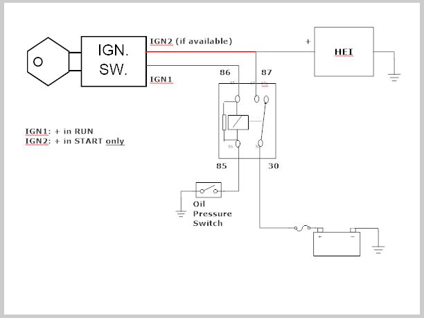

Rick, this is how my 65 Belvedere is wired. My ignition switch has IGN1 an d IGN2 contacts. IGN1 is the ignition power in normal running mode. IGN2 is the resistor bypass line to the OE ignition coil. I use IGN2 to supply power directly to the HEI module when starting. This is to insure the oil pressure switch has time to close (oil pressure) for the relay to have its ground connected for the RUN circuit.
Your truck may not have a 'resistor bypass' circuit, which is why that particular connection is shown in red as optional.
Hope this helps.

That's a good schematic, but IGN2 is not optional. Unless you want the engine to crank and crank until it gets oil pressure.
PostPosted: Sun Jan 17, 2021 8:15 am
Posts: 1470
OK, I made a small correction.
On my 65, it is not optional.
I meant it might be optional on an 85 Ram truck. I don't know what the ignition switch outputs are for that particular vehicle.
I don't know if Rick's truck has separate IGN1 and IGN2 circuits.

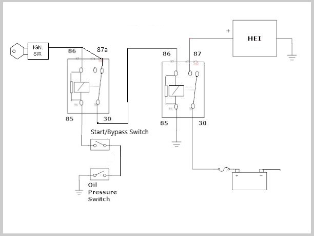

Yes, electronics are my trade. Drawing on the computer is not though so I can't easily create a diagram for you, but I think I can do one without going crazy. In fact I'll cheat and use MattMan's and go from there.
This diagram will get you an engine that only has ignition power when the ignition switch is on AND the oil pressure switch grounds the HEI relay. This is opposite operation of most oil pressure switches. With your existing ground-on-low-pressure switch the engine will only have ignition power with low oil pressure.
What do we do? Change the switch to one that opens on low pressure to de-energize the HEI relay or add a second relay as a cut-out. This is the second diagram. Cut-out relay is on the left. Circuit operation is like this... With the ignition switch on and bypass switch open the ignition will always have power through the cut-out relay's normally closed contacts. With the ignition on, bypass switch closed and the oil pressure switch closed the relay will energize and open the contacts killing control power to your HEI relay. Open the bypass switch or oil pressure switch the relay is de-energized and ignition switch power passes to the HEI relay.
Do I really need a second relay you might be asking? No, you don't. But that's another diagram, the circuit explanation is a little more complex and component selection becomes more important.
Honestly I would not have the ignition cut off by low oil pressure for safety reasons. What I would do is a warning buzzer like air-brake equipped vehicles are supposed to have. Low oil pressure would turn on the light and buzzer. The operator would then make the choice of whether or not to kill the engine.

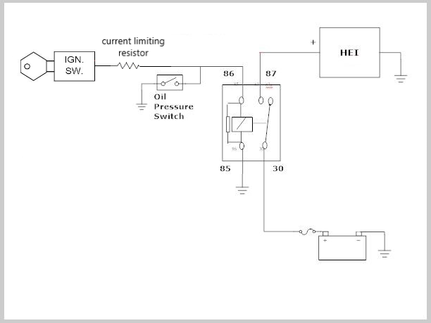

The ignition kill can lead to a loss of vehicle control. If you lose oil pressure in a corner, cutting the ignition it can severely change the torque applied to the rear tires by immediate application of full engine braking. You could quite easily spin out and hit an immovable object. Do you want that to happen at 100 MPH? Cars aren't built with low-oil shutoff. This is a motor vehicle, not some stationary engine running a water pump or some such. You are more important than the engine. Unexpected loss of power could cost you your life.
Put a current limiting resistor in your ignition feed to the relay and you'll stop blowing fuses. Move the oil pressure switch connection to the relay coil. The oil pressure switch will pull down the voltage to the relay coil so that it opens. If you want to be able to start the engine without oil pressure put a switch in line with the oil pressure switch to disable it. Don't do this in a motor vehicle! Only do this for circumstances where losing engine power will not endanger life.
