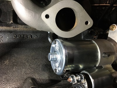

Here is a new set of Aussie Speed Dutra's on a 170. It took the RobbMC starter to make it work and it was still close. But I got them on with enough room to install a heat shield. Solenoid needs rotated down towards the pan rail.

If you look close the bottom of the mounting flange was narrowed by about 1/8" and I also shifted the entire manifold up a 1/16" or so. Then worked the inside of the manifold port floor the same amount. Lots of massaging here and there, but it will work.
