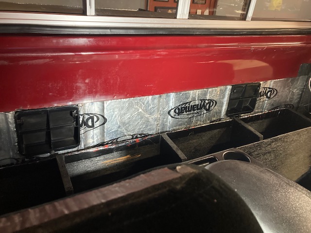

* Added a cab vent, since I changed out the door seals when I re did the truck, it takes a really good slam of the door to get it to close with all the windows up. I got a set of these vents at the pull a part. I installed one of the vents in the rear cab wall behind the driver seat. Photo below. It has helped a lot.

Added a cab vent,
John, I take it you were able to install the vent with the bed on the truck? What are they off of. That is a really good idea.
 Post subject: Re: 83 D-150 Project
PostPosted: Tue May 11, 2021 4:09 pm
Posts: 3857
I did, used a Dremel with a cut off wheel to cut the opening. As the vent mounts from the inside was easy to put in. Not sure what the vent came from.

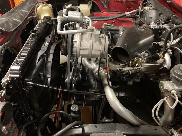

The OE radiator had started seeping at the bottom corners this past summer. I had it re cored locally.
Looks like the shop did a good job, it did take almost three weeks for them to get the
correct size radiator core in. Put in a new 195 thermostat, the hoses were all changed out last year when I pulled the motor
for the cam change so they are still good.
I added one cab vent last winter to help evacuate the air out when closing the doors with the windows closed.
That made a big difference. I had a second vent and I installed it.

I got the cab vents from the pull a part years ago,
It is Chrysler part number 4432752
mine came from an '88 D150 but I bet they were used for several years.
Looks like Dodge put them in the door, I put mine on the back of the cab.
