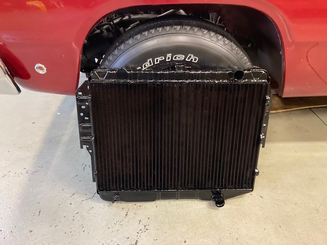

The winter-time do list on the 83 D150 was short this year.
The OE radiator had started seeping at the bottom corners this past summer. I had it re cored locally.
Looks like the shop did a good job, it did take almost three weeks for them to get the
correct size radiator core in. Put in a new 195 thermostat, the hoses were all changed out last year when I pulled the motor
for the cam change so they are still good.
I added one cab vent last winter to help evacuate the air out when closing the doors with the windows closed.
That made a big difference. I had a second vent and I installed it.
I changed the engine oil before parking the truck back in November, I will lube the chassis and it will be set for this April.

 Post subject: Re: 83 D-150 Project
PostPosted: Wed Jan 19, 2022 4:58 pm
If it's the bottom tank to core seam, just go over it with a plumber's torch and solder..........
