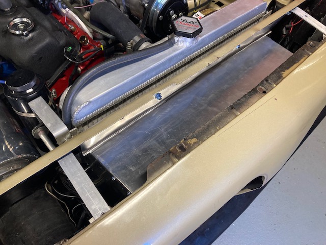

Finished the grill install and the revised radiator ducting today.

I will wait for warmer weather to do the polish and paint.

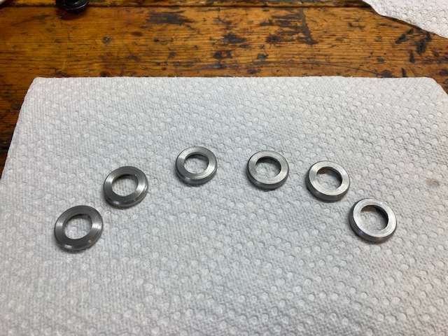

When building the cylinder head I took it to a shop to get the intake valve seats cut to hit the target on the spring pressures. The guy did not have a hollow mill that left the ID of the spring seat in tact, I was pissed. This is the plan is to fix that. While at the PRI show I spoke with a couple of valve spring suppliers and they all agreed that the spring should be retained at the bottom, either on the ID or the OD. One of the guys said that if I could find a washer of the right ID and OD and thickness and epoxy it to the existing seat area that would stabilize the bottom of the spring.
Found a steel washer at Mc Master Carr that has the correct OD, a workable thickness and the ID is close enough that I can do some minor honing- grinding to make a custom fit. I have those ordered.

Finished the project of adding the valve spring bottom retention that had been machined away on the intake spring seats.
The McMaster Carr thick washers were about perfect. I had to hone out the ID to get a good fit over the valve guide, the OD was fine.
I cleaned up the cylinder head valve seat surface with brake cleaner then acetone, then used JB Weld epoxy to fix the washers in place.
The valve spring removal tool worked great.

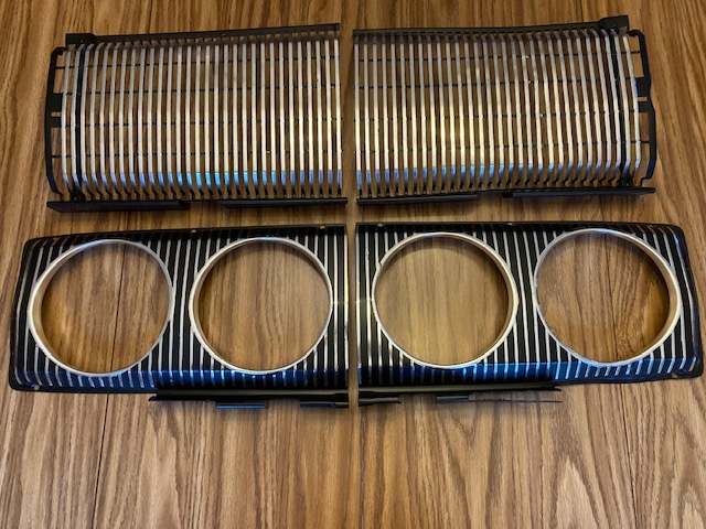

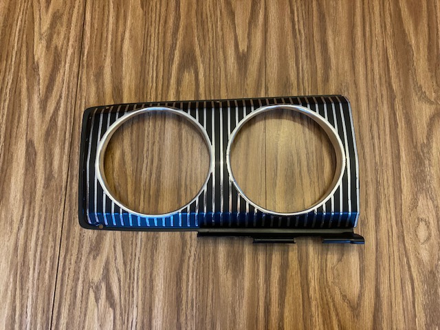

Back on the grill work, this has been a cold spring in Indy, been waiting for the temperature to get up in the mid 60's to spray paint.
photos below are of the bezels and grill sections. Polished and painted.
