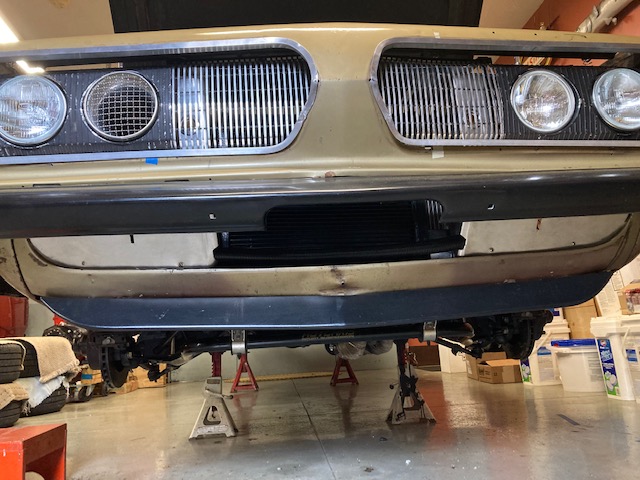

Made the trim to surround the front grill and headlights. Used aluminum angle stock from Lowes, heated it with a torch to get soft enough for bending and then braised the ends together using a propane torch and aluminum brazing rods. Practiced some new skills on this project.
Some of my goals on this project were:
1) maintain the OE shape-size-attachment points to make it easy to return to the stock grill surrounds
2) utilize qual head lights with one opening being a cold air intake
3) the change is to have a positive effect on the front end aerodynamics and remove weight.
4) have the new front end look like something that Chrysler/Plymouth could have done back in 1968
The 1967 Dodge Coronet grill insert and head light surrounds have not been cleaned or re painted. That will happen with warmer spring weather. That gives me time to decide to: black the grill and bezels, or make them all shiny, or a combination of both.

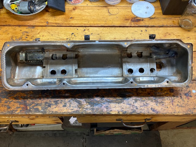

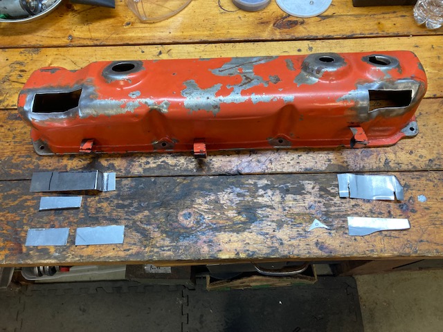

This post shows the Roller Rockers and the valve cover revisions made to provide clearance for the rockers inside the valve cover after the B3 spacers were installed.
The B3 spacers moved the rocker shaft up a bit over .200 I checked the clearance with molding clay, rolling the engine over by hand. The outboard adjusters hit the valve cover hard. The adjusters below the valve cover internal baffels just touched the baffels. This is with a valve cover gasket installed in the valve cover.
Link to the B3 discussion https://www.slantsix.org/forum/viewtopi ... 19&t=66466
To provide a safety margin I repeated the clearance test with the valve cover gasket removed and the valve cover bolted in place and made modifications for clearance.
Photos below show the Roller Rockers, the valve cover modifications, and a side by side comparison of a stock valve cover and the modified valve cover.
I applied Loctite 290 to the welds. Loctite 290 is a wicking fluid intended for sealing porosity in welds and metals.
The cylinder head I am using is a 1987 Hydraulic Head and valve cover.
