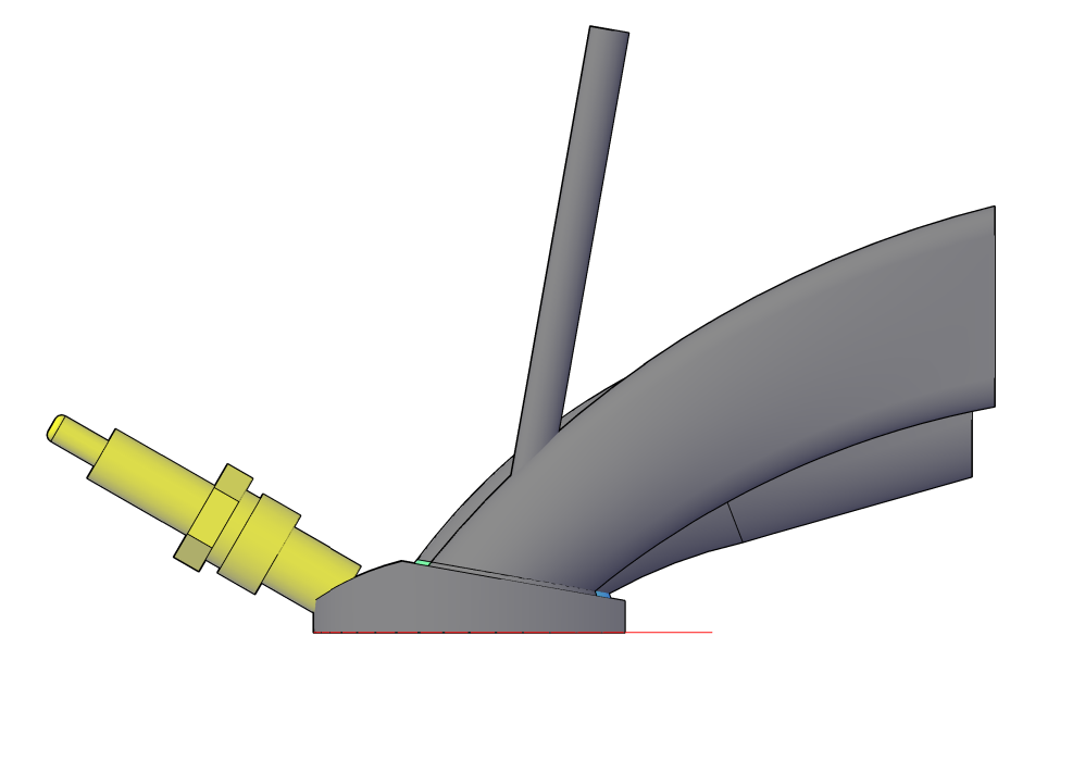

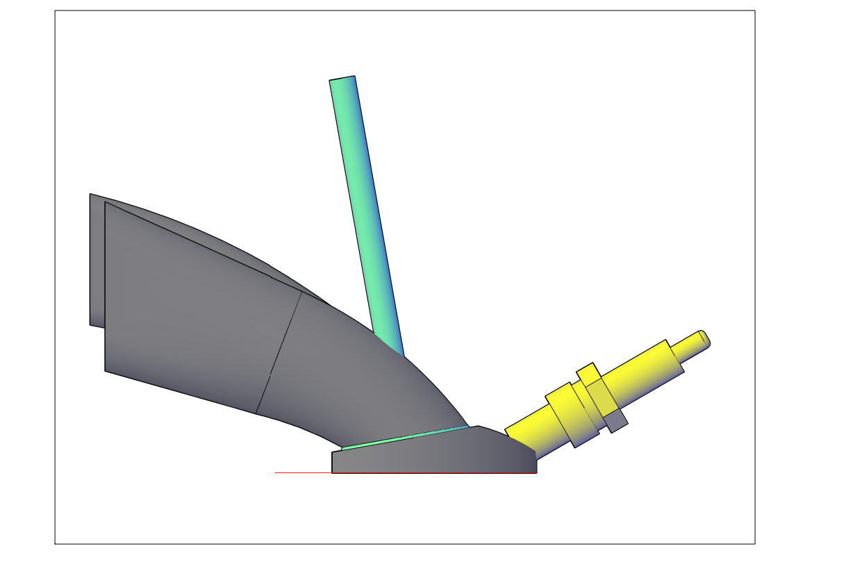

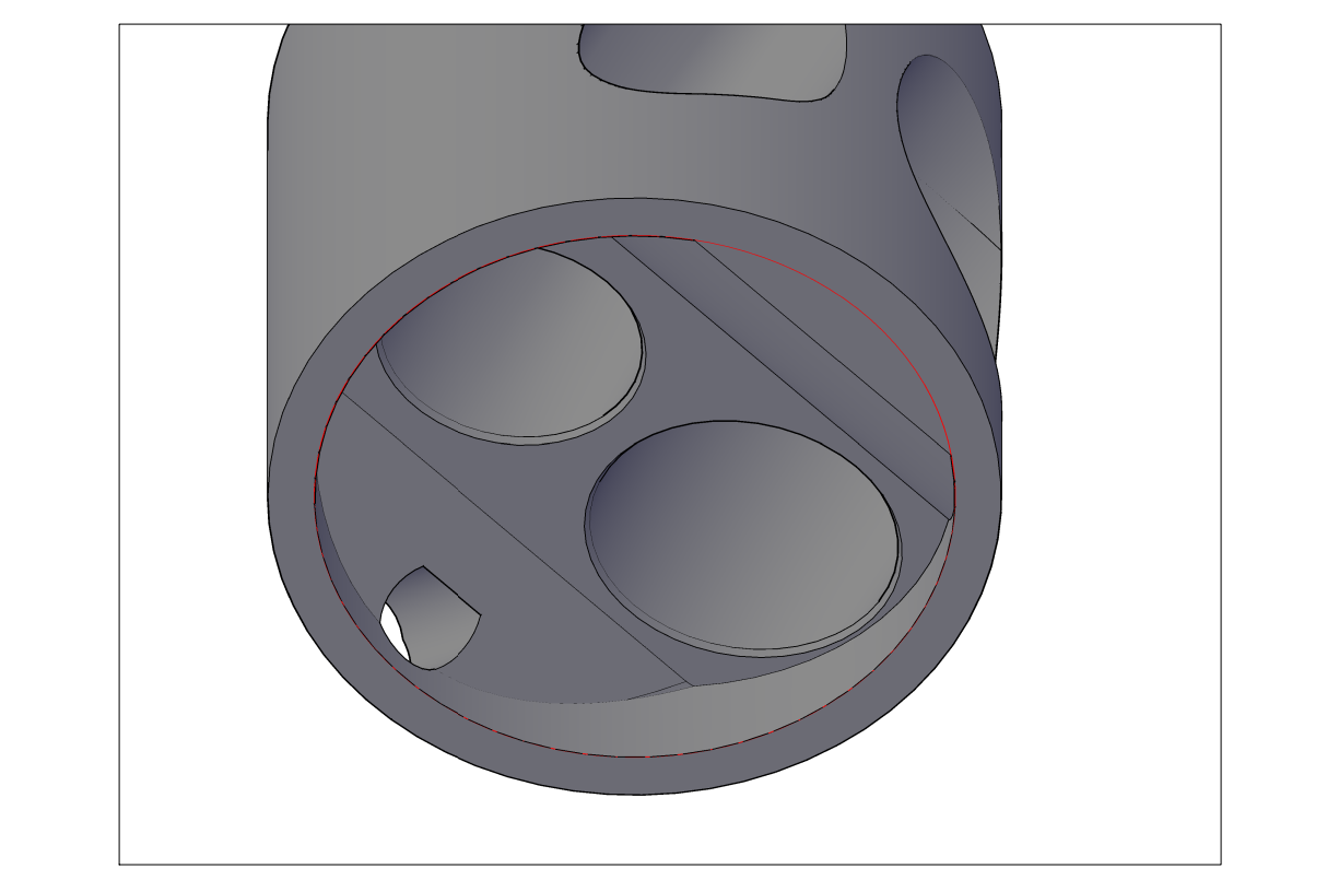

Here is what I think we need and can use.
This would be a big seller.
An Aluminum head.
Swirl port chambers.
1.75 Intake valves.
1.50 exhaust valves.
Narrow stem valves, .200 taller than stock.
Larger intake and exhaust ports with improved shape and flow.
Late model small plugs.
Everything else stock spec to interchange.
Stock design with some major and minor changes
1. I do not know about how strong the head would be made out of aluminum, but I do know that I have made almost every section of wall thicker than stock slant wall.
2.I do not know how to design swirl port chambers in AutoCad
3. 1.75" intake valves, 1.50" exhaust
4. intake is 3.17"^2, exhaust is 1.70"^2
5. normal sized plugs, maybe 2 smaller plugs later
Looking for feedback of any kind.
Intake is the blue valve
Using rockers like the Ford Cammer OHC engine with an adjustable lash surface that can be swapped out for a cup or ball lash adjuster, this head can be SOHC, or pushrod driven
File comment: The Ports are angled 90 degrees to the deck surface because it reduces head weight and allows for injectors to be positioned at a better angle (shown in yellow) (Manifold is just a sketch)

File comment: red ring is 3.5 diameter circle
