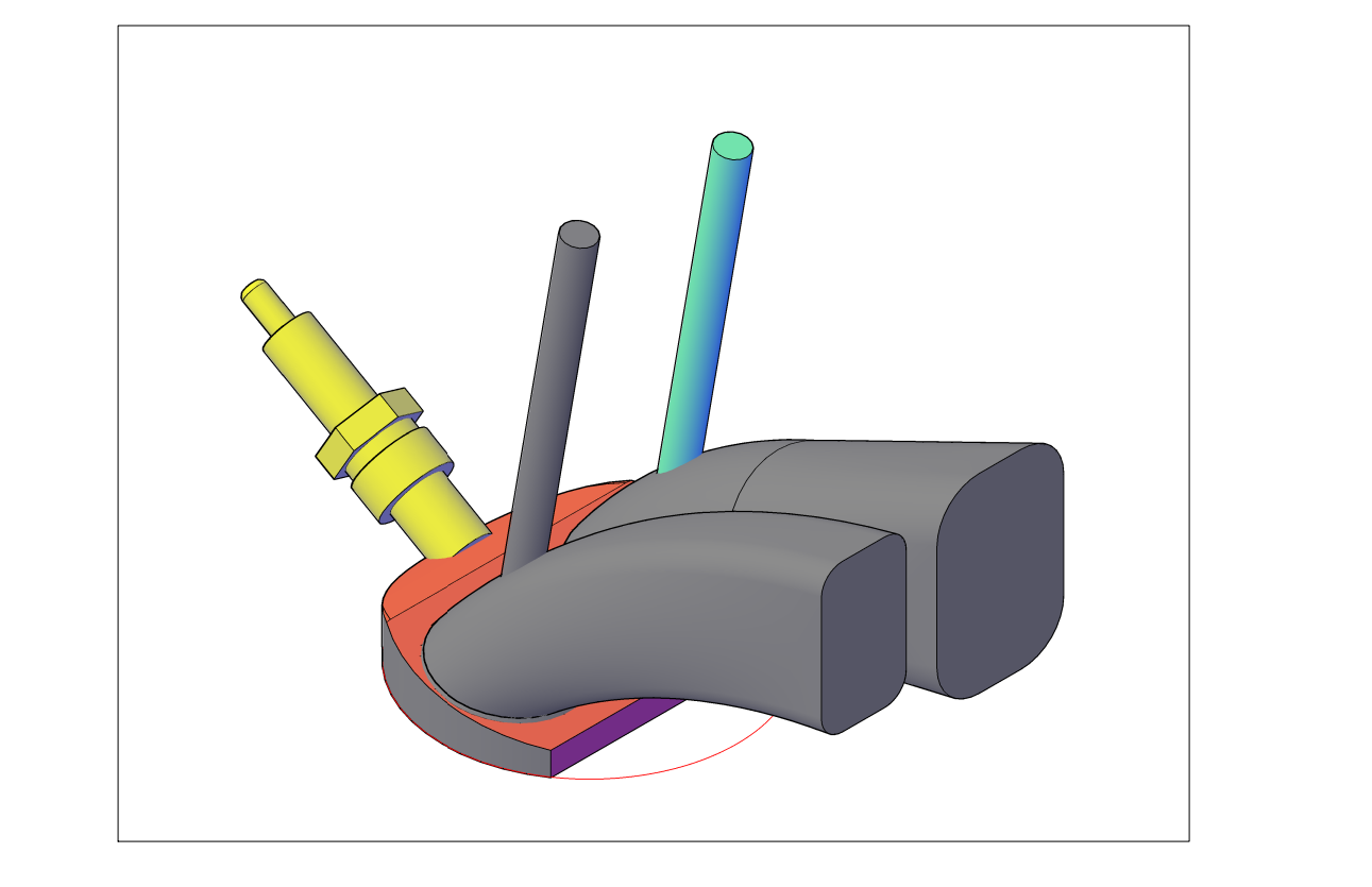

 Post subject: Re: cross-flow slant?
PostPosted: Tue Oct 11, 2022 6:17 am
Posts: 17668
Agreed, Stan. You can get a lot of flow out of a Slant head without making it cross flow. All we need is $100k and some time to get the project done...
PostPosted: Tue Oct 11, 2022 5:56 pm
Posts: 1506
Location: San Antonio, Texas
Car Model: 1964 Valiant
The reason a 2JZ can make so much power isn't the heads but the very strong block with high turbo boost.
The Jaguar 3.8 E type with the hemi heads has decent output for a '50s design but it is still rpm limited by the long stroke (basically the same as a 225 ). Factory race teams spent high dollars to get beyond 6,000 rpm. The strength of the XK6 was its torque - it was last used in a British military truck. Some have used titanium rods and billet cranks to get about 400 hp on a barely streetable E-type. The ancient block design really needed a "cradle", the blocks sometimes split when the crank flexes at high rpm.
I think a slant head head based on the Toyota 3TC hemi (itself based on 1950s Dodge hemi) could work, these only had about 75 hp from 1.8 liters, but race heads have produced 800 hp with a turbo. Billet 3TC heads are available for $2,000 - could be $3,000 for a slant six version.
My preferred slant six head would resemble the OEM head with an "improved" combustion chamber, raised and straightened intake ports - might need a remote air cleaner for hood clearance in some cars. I doubt if it would add more than 10 hp with a stock camshaft, but hopefully could tolerate higher compression on pump gas for more torque.
Many of us are impressed by a slant six with, say 185 hp. A nice head would be a novelty for most of us - who don't buy new cars and might spend the money for something cool that a grandson might inherit.
PostPosted: Tue Nov 15, 2022 2:45 pm
Joined: Mon May 23, 2022 6:24 pm
Posts: 7
Car Model: 75 Dart
Here is what I think we need and can use.
This would be a big seller.
An Aluminum head.
Swirl port chambers.
1.75 Intake valves.
1.50 exhaust valves.
Narrow stem valves, .200 taller than stock.
Larger intake and exhaust ports with improved shape and flow.
Late model small plugs.
Everything else stock spec to interchange.
Stock design with some major and minor changes
1. I do not know about how strong the head would be made out of aluminum, but I do know that I have made almost every section of wall thicker than stock slant wall.
2.I do not know how to design swirl port chambers in AutoCad
3. 1.75" intake valves, 1.50" exhaust
4. intake is 3.17"^2, exhaust is 1.70"^2
5. normal sized plugs, maybe 2 smaller plugs later
Looking for feedback of any kind.
Intake is the blue valve
Using rockers like the Ford Cammer OHC engine with an adjustable lash surface that can be swapped out for a cup or ball lash adjuster, this head can be SOHC, or pushrod driven
File comment: The Ports are angled 90 degrees to the deck surface because it reduces head weight and allows for injectors to be positioned at a better angle (shown in yellow) (Manifold is just a sketch)
File comment: red ring is 3.5 diameter circle
File comment: Basic design similar to stock
valve angle 10 degrees
Bottom of ports is 1.5" from the deck surface
