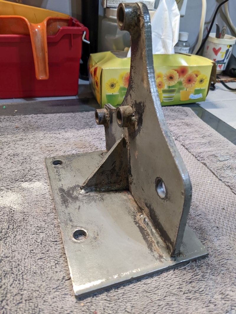

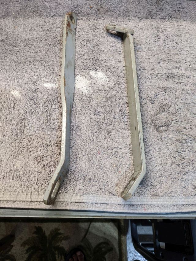

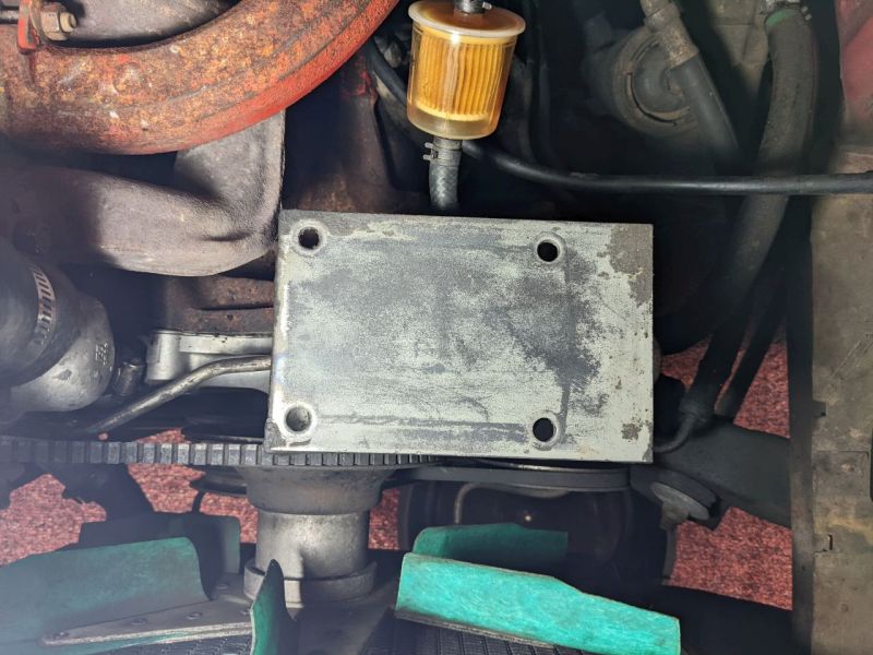

A few pictures of the job
File comment: Stabilizer bars, side view
File comment: Stabilizer bars, top view
File comment: Adapter off, water pump secured
File comment: Adapter on, front view
File comment: Adapter on, top view

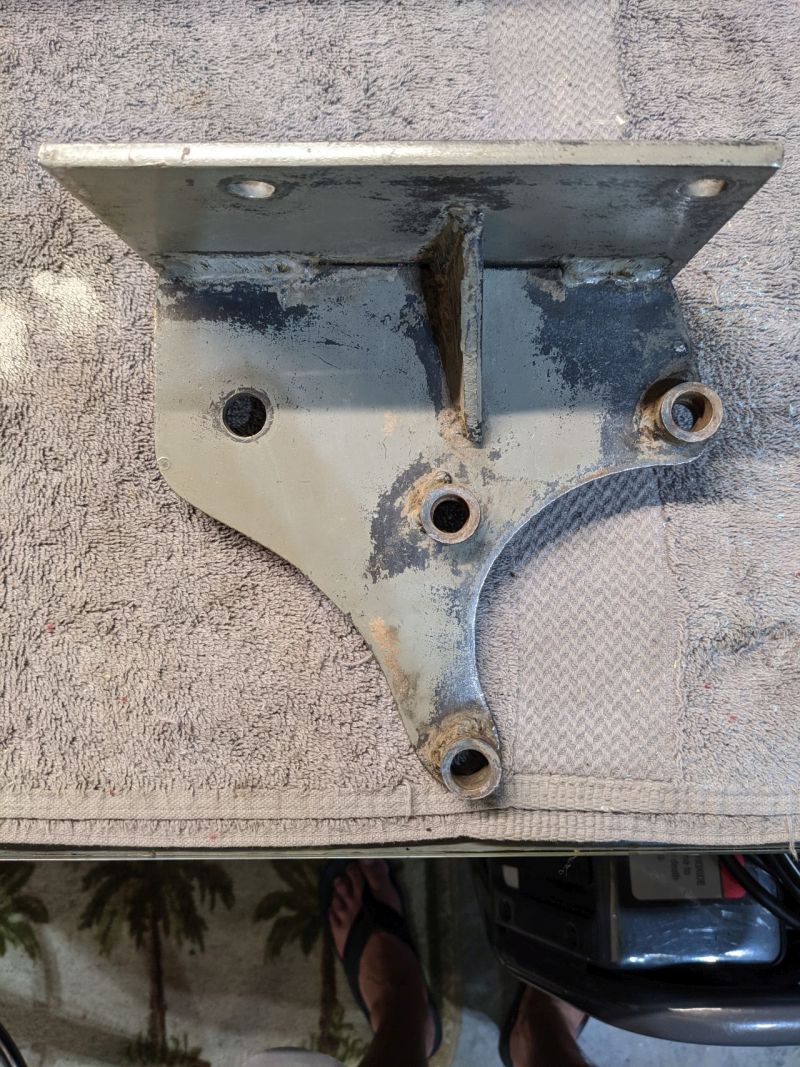

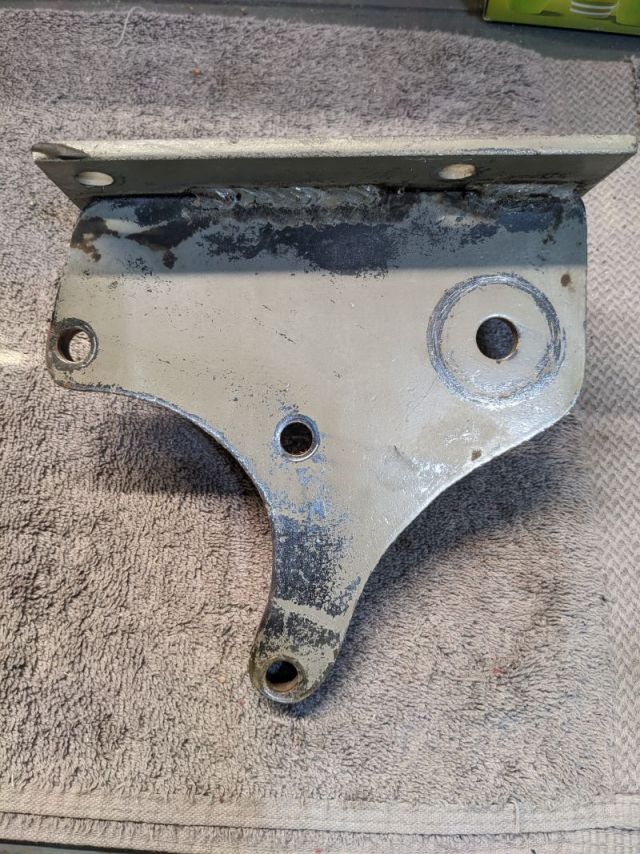

A few more pictures. The compressor was mounted horizontal in my case - some are done vertically.
File comment: Adapter off, front view
File comment: Adapter off, underneath view
File comment: Adapter off, back view
