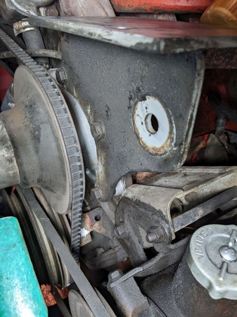

I am in the process of removing an aftermarket Frostemp 400 A/C system from my 1966 Coronet Slant Six. I have removed all components except the adapter platform that the York compressor sat on. That adapter platform is mounted to the engine using 3 of the 6 water pump mounting bolts (top, upper right, and lower right facing the engine compartment from the front). Will there be a problem in removing and re-installing those 3 water pump mounting bolts while I remove the adapter platform? Will there be a water leak? Is there a best way to do this? Note, the water pump and gasket a fairly new and look to be in good shape - they were replaced less than 5 years ago according to the documentation I got when I purchased the car in May 2022 and the car has been driven very little over that time. Thanks for the help!!

It is hard to say for sure, but I think you will be fine as long as you do not stress/deform the water pump case or put a significant load on it while you are removing the AC unit. Put the mounting bolts back in (or possibly you will need to find/buy shorter ones so they do not bottom out) and it should maintain the seal. You may have some water leak out while the bolts are out, so a suitable drain pan under the car is advisable.

Those three bolts are "thru" bolts. As long as you don't loosen any other bolts you shouldn't have any leaks. As stated above, you might need bolts, about 3/8 to 1/2 shorter.

The job is complete. The A/C mounting bracket has been successfully removed without any issues with the water pump. As you folks mentioned above I did have to get a couple shorter bolts. This is because the adapter bracket added almost 3/4" (1/4" thick steel plate + mounting bosses) to needed mounting bolts. I took out 1 3/4" bolts and replaced them with 1" bolts which fit perfectly (plenty of thread length without coming out on the back side of the through holes). And, yes, the adapter bracket and stabilizer bars are full 1/4" thick steel!

A few pictures of the job

A few more pictures. The compressor was mounted horizontal in my case - some are done vertically.
