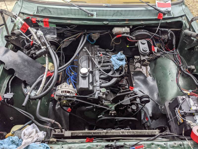

We pulled the motor over the past weekend. We found that the engine has already been bored to 060 over and it needs to be cleaned and so needs more boring or a sleeve job. Sleeves would add a significant expense - I've been trying to find if there's any danger going to 070 or 080 over on this block? Anyone have any actual experience with that? If so, where would you recommend I source those pistons, since I assume they'd need to be custom. I called Egge and checked several web sites, but anything more than 060 over isn't stocked anywhere I've found.
