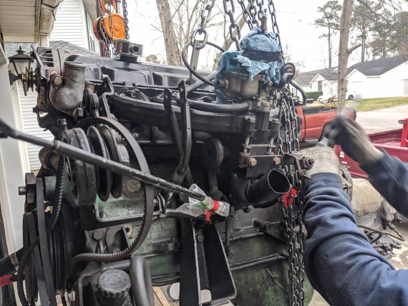

PostPosted: Wed Feb 08, 2023 6:08 pm
Joined: Sun Jan 22, 2023 5:07 pm
Posts: 32
Location: Upstate South Carolina
Car Model: '85 D100 with an early 60s 225ci
We pulled the motor over the past weekend. We found that the engine has already been bored to 060 over and it needs to be cleaned and so needs more boring or a sleeve job. Sleeves would add a significant expense - I've been trying to find if there's any danger going to 070 or 080 over on this block? Anyone have any actual experience with that? If so, where would you recommend I source those pistons, since I assume they'd need to be custom. I called Egge and checked several web sites, but anything more than 060 over isn't stocked anywhere I've found.

PostPosted: Wed Feb 08, 2023 7:32 pm
Posts: 3299
Located where? Slants are still pretty readily available, might be better to start fresh with another.
I know where there's one at, and it's even out of an 85 truck. All stock, running engine.
PostPosted: Thu Feb 09, 2023 1:41 am
Posts: 17668
What year is the engine? Not sure about '80s cast crank blocks, but anything earlier than 1980 can likely go 0.100 over. Why do you think it needs to be bored? Does it have substantial ring ridges? You might just hone and put in new rings and bearings.
PostPosted: Thu Feb 09, 2023 9:47 am
Posts: 32
My block is an early 60's vintage (3 frost plug design).
It does have a ridge and so needs boring. You mentioned it could go 100 over - what piston manufacturer are you referring me to?
PostPosted: Thu Feb 09, 2023 9:50 am
Posts: 32
I've been shopping for weeks before I pulled the motor and cores are not easy to come by near me. They're still out there...just not anywhere near me and since I'm in a bit of a time crunch, I need to move forward with what I have since the engine is already out.
PostPosted: Thu Feb 09, 2023 2:46 pm
Posts: 3299
Cuz you need one "now" when that isn't the case... But when you aren't looking they are all over the place
PostPosted: Thu Feb 09, 2023 2:50 pm
Posts: 17668
Right now, you may need custom pistons to go 0.080 - 0.100" over with stock 225 rods. If you use 198 rods (7" long), there are a bunch of off the shelf pistons in 0.084 - 0.105" over.
