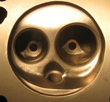

I think my head is the "169" head and that is what Mike asked me to send for porting if I had one.
PostPosted: Sun Feb 26, 2023 6:13 pm
Posts: 2736
169 is a drool tube head, 67 to 74, with the chamber wall stood up more vertical than the earlier head.
On the spark plug side.
That chamber shape is better, I agree with Mike.
