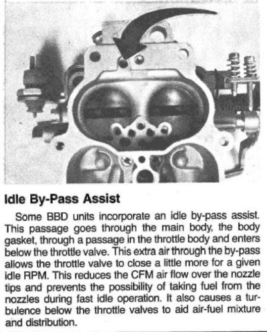

Port 7 is another vacuum line under the fuel inlet. A bit hard to see in one pic.
I'm not changing my timing. If I get great stable low-speed idle and great vacuum at 10 BTC on 87 octane ethanlol junk then it's staying at 10.
These engines waste so much gas when idling, the slower the idle the better.
Current state of mixture screw "unresponsiveness" is with all ports capped as recommended, PCV is connected, bowl vent is open, and with timing set at various between 0 to 10 BTDC.
I'm considering buying an air-fuel ratio guage, which involves mounting an oxygen sensor in the exhaust pipe. There is one on amazon described as "30-0300 Wideband UGEO Air Fuel Ratio Gauge 52mm(2-1/16"), AFR/Lambda Controller Kit with LSU 4.9 Sensor" for $170 CAD, seems highly recommended.
