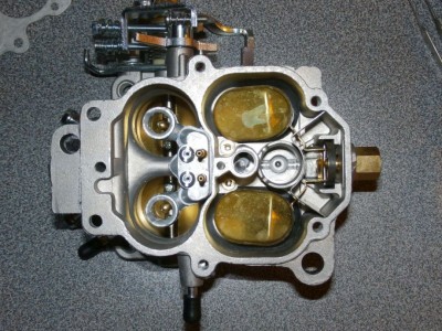

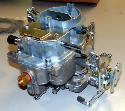

Here is a pic of the carb:

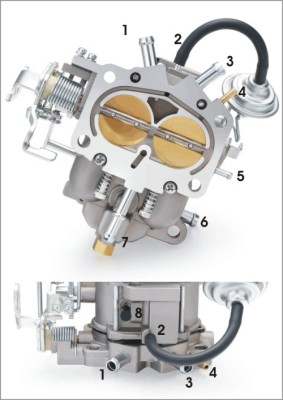

Here are some views showing the ports:
Port 4 is the one where if it's open, the warm idle goes up a little, and when cold starting the engine runs much faster right off the bat. I'll connect a vacuum guage to this port to measure manifold vacuum. I'm currently getting 18 or maybe 20 inches at warm/hot idle, timing is 10 BTDC. I must say that turning mixture screws don't seem to have much effect at idle, I'm not finding a setting that gives a sharply-defined smooth running and peak vacuum like I remember from years ago when adjusting other BBD and the BBS on my slant-6.

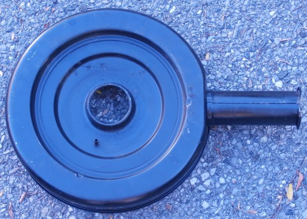

Here is the bottom of the air cleaner:

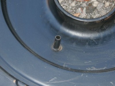

Close-up:

That's a copycat version of a '77-up "solid fuel" BBD. Can't see the telltale choke lever configuration because there's no pic from a suitable angle, but looks like probably a copycat 318 carb; where does the idea come from that this is a Super Six carb clone?
Port 8: venturi vacuum tap for EGR, not used in your application; cap it.
Port 7: fuel inlet
Port 6: bowl vent
Port 5: distributor vacuum advance (probably; can't 100% tell from this angle)
Port 4: manifold vacuum to thermostatic air cleaner, not used in your application; cap it.
Port 3: canister purge inlet, not used in your application; cap it.
Port 2: choke pull-off
Port 1: PCV inlet
Nipple on underside of air cleaner means you have an unusual air cleaner, configured for use with a heat-tube type automatic choke or a throttle anti-ice system. Not used in your application; cap it.
timing is 10 BTDC.
Bit much, back off to 5°.
This might change once your initial timing and idle speed settings are corrected and unused ports are properly capped.

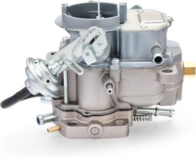

Port 7 is another vacuum line under the fuel inlet. A bit hard to see in one pic.
