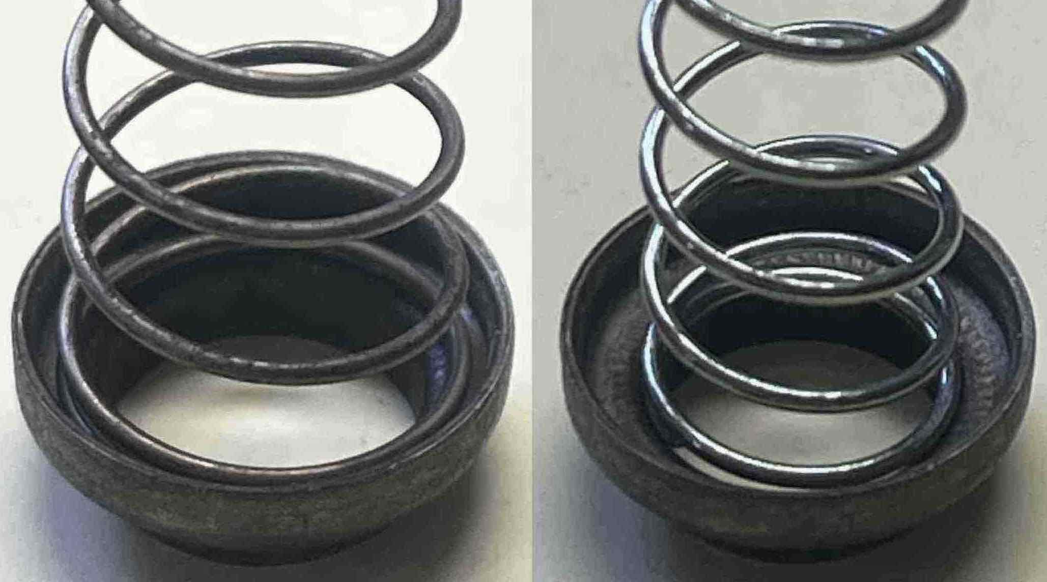

Big thanks to Dan Stern for the help locating the correct rubber-coated washers that are now keeping the fuel inlet dry. And also for the advice about the needle/seat situation. Sourced a new (original design) needle/seat inlet and already things seem drier than they ever have been.
I opened the carb back up not only to install the correct needle and seat, but also to inspect the check balls to be sure they weren't stuck, and to find out why I'm not getting a healthy squirt of fuel whenever the accelerator pump engages. Turns out, even with my normally-diligent carburetor cleaning, there were nearly invisible, gummy deposits clogging the inside of the accelerator pump jet. I had to get out a sewing needle to help clear the passages. Once clean, a pump test with fuel in the bowl finally resulted in a relatively light spray of fuel through the jet into the carb throat. Good. Re-calibrated the float levels, then re-installed the carb.
For a short time, the driving/running improvement was noticeable. I'd step on the gas, there was no stumble. I could actually observe the pump working. Then, I noticed that sometimes the pump sticks. You'll work the throttle linkage and the pump will plunge down slowly, if at all. I know I've done the preconditioning of the leather cup correctly, and after driving it last night when it was stumbling all over the place, I'm thinking my accelerator pump spring may be the issue.
I have reused my old pump spring many times because it seems tapered correctly from narrow at the plunger end, to wider at the top end to mate with the metal 'cup' that seals the pump vent hole. The new accelerator pump springs that come in the Daytona kits do not taper at all. Their coil is wound too tightly so the end of the spring that rests inside the rim of that metal cup doesn't sit around the edges of the cup correctly to press it firmly up against the inside of the airhorn; all the spring wants to do is poke through the center hole of that cup seal.
Given I'm going to have to open the carb back up again to work through the pump issue, it's worth asking: is the pump spring supposed to be tapered? Or is it supposed to be straight, and I just have a too-narrow spring? Please give me your thoughts, thanks.
What's 'relatively light' mean here?
H'mm. Sounds like intermittent blockage between the bottom of the plunger well and the outlet of the pump jet. Could also be some part of the linkage or spring hanging/snagging/binding.
Confirmed; that's the correct design. Carefully stretching this spring pays dividends. Grab it with pliers at both ends and stretch it just past the point where it springs back to exactly where it was before. Not too far, or you'll spoil the spring. You want it to wind up just a little longer than it was.
More I hear about Daytona's kits lately, dimmer my view of them. This plus the other bum parts already mentioned move them into the do-not-buy category as far as I'm concerned.

Original spring length measures 1 5/8". Daytona spring measures 2 1/8". Now, I'm questioning their parts, wondering what length is correct. But Dan, you said stretch the original spring so it returns to just past its original length, that would still be a good deal shorter than the Daytona spring...?
PS: MAN, that original spring does NOT want to stretch longer! It keeps returning to the same length and I’ve gone past where I think I’d need to go to get it to stretch. Stern stuff this old spring.

Thanks to everyone who's weighed in on this. Finally got the original spring stretched a bit and reassembled.
Wow. :shock: What a nice difference that makes! No stumble at all. Strong jet of fuel on acceleration. Drives like it should now :D
