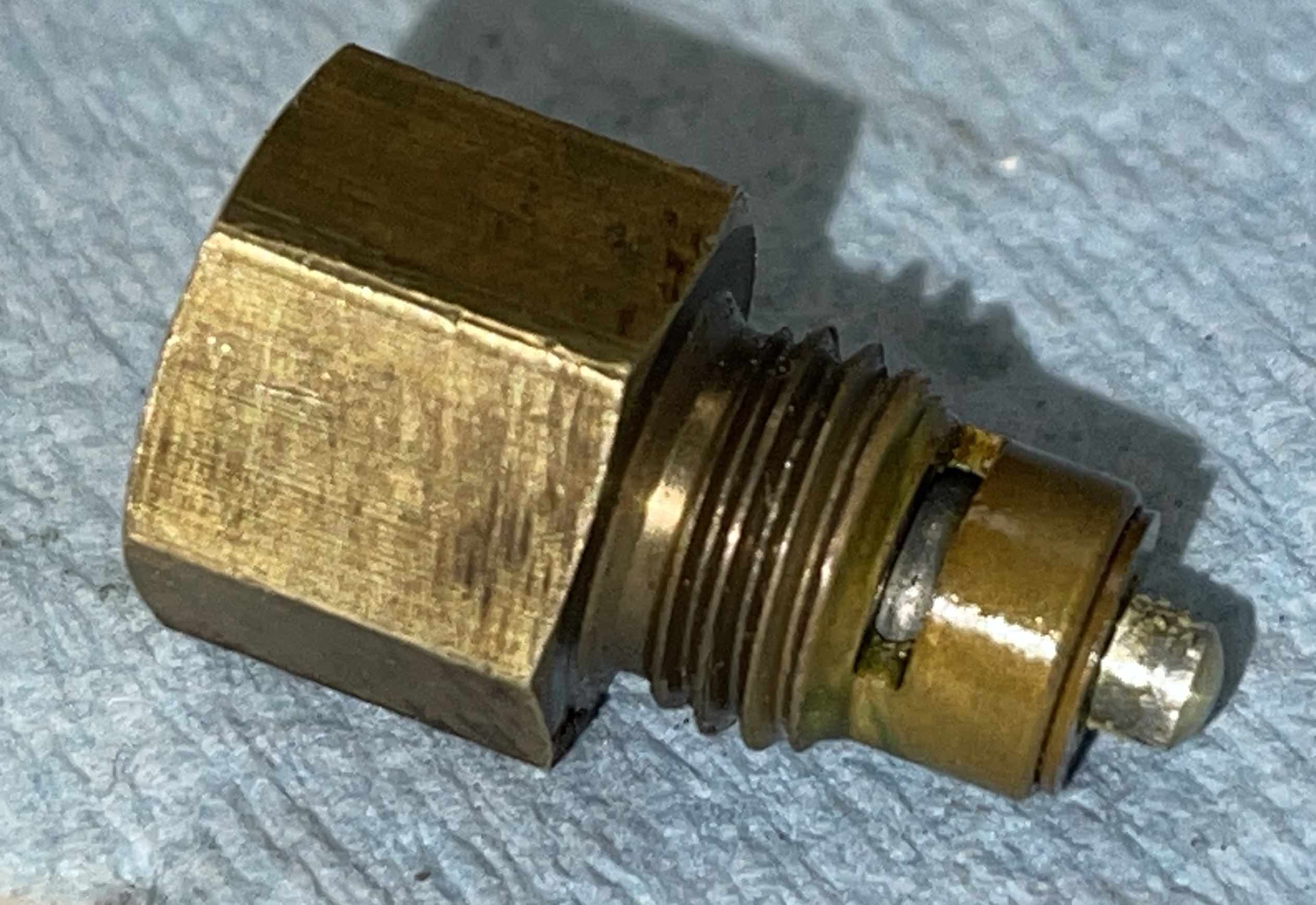

More I think on it, more I suspect your float valve is making a pest of itself. That "Daytona Float Valve" they claim is so much better than a regular ol' normal ol' boring ol' inlet needle and seat, that's a copycat of the old Tomco "Duro-7" design, and — assuming it was a good design in the first place — something might've got lost in translation. I can think of a few ways a not-quite-faithful copy would cause problems such as you're having.
Too, and secondarily, I've never liked those red fibre inlet fitting gaskets. The rubber-coated aluminum ones seem to do a better job of keeping things dry. Might wanna sigh, grumble, and fetch a kit from Jon Hardgrove at TheCarburetorShop.com . It'll have the regular kind of inlet needle/seat, and together with careful float readjustment will likely solve all or most of the problem(s).
I've probably rebuilt this carburetor at least three times in the last 15 years. Only this last rebuild did I finally try that "new" Daytona float valve you say is a copycat design. I've tried using it in the past and had problems with it. The first two rebuild kits from Daytona came with two different options for the fuel inlet: 1) their 'new', copycat design, and 2) some kind of a brass fitting that has some sort of pressed-together plunger-seal valve. I ended up using that one because it worked. I saved that fitting: perhaps I'll re-use it for now. Pictures of it attached, below.
Thanks for the advice. I'll attempt to source a different, rubber coated, gas-resistant washer for that location. Perhaps a kit from Jon would solve some of these problems, probably not the accelerator pump issue I'm having though...?

That's a Holley-type design which works well on certain Holley carburetors. It does not belong in your Carter carburetor, where its side-discharge configuration will tend to make gasoline want to exit the carb through the bowl vent…in exchange for zero benefit.
Writing this now, I'm thinking back on other nonstandard float valve designs. The Grose-Jet, for example, used two metal balls and no rubber. Similar claims as for the Daytona Float Valve: ZOMGWOW!!1!!!!!1!!! GREAT MASSIVE BIG IMPROVEMENT IN CARBURETOR FUNCTION!!1!!!1!!! REVOLUTIONARY NEW DESIGN THIS CHANGES EVERYTHINGS!!!!1!!!!
I found the Grose-Jet didn't practically improve anything about carburetor operation, and it made new problems very much like those solved by the 1961 introduction of the rubber-tipped inlet needle.
So anymore, I'm inclined to file magic carburetor float valves right along with magic spark plugs, under N for Nope.
:!: Ahh....no wonder the bowl vent area has appeared wet for years. Never put that together. Well...shoot. Need to change that out to the tried and true needle/seat.

Big thanks to Dan Stern for the help locating the correct rubber-coated washers that are now keeping the fuel inlet dry. And also for the advice about the needle/seat situation. Sourced a new (original design) needle/seat inlet and already things seem drier than they ever have been.
