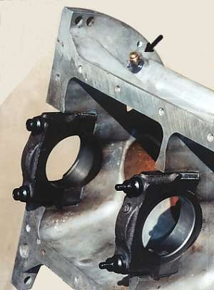

Are you using ARP main studs? You may want to bolt the main caps to the block and make sure the fasteners are not protruding into the oil galley feed holes running down to the mains. You can run a drill or reamer down these holes to be sure they are smooth and clear. You will have to stop at the cam bearings unless you plan to replace those. (The cam bearings will also "pinch down" the feed holes)
I spend a lot of time opening-up the oil passages on a SL6 and "blending" (grinding-off) all the sharp edges and interferance / restriction points.
One other trick is to install a fitting at the back of the main oil gallery, on later cast iron blocks there is a boss already there. Run a hard line from the oil pump's tapped hole, right below the filter base and back to this added fitting. This gets oil pressure directly to the rear main and #6 rod, without having to do the 180 degree turn-a-round at the oil pump mounting pad.
(This is a V8 trick I carried over to the SL6, many V8s (like the Big Block Mopar)run the oil down one lifter galley, cross-over then run the oil back up the other side's galley, the last parts in the line have to wait a while for oil)
Close-up of "by-pass" oil feed to rear main passageway
