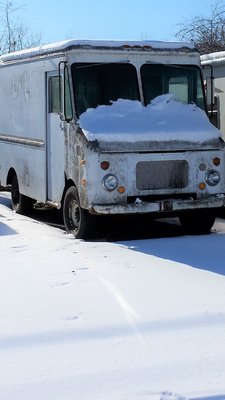

Here are a couple of pics of it.....
File comment: last winter...

Cool. That would sure make an awesome track day vehicle. With plenty of room for napping and spare tires etc.

I like it! Lots of potential there. A local coffee shop converted an old Citroen step van to a coffee truck. Keep us posted.
