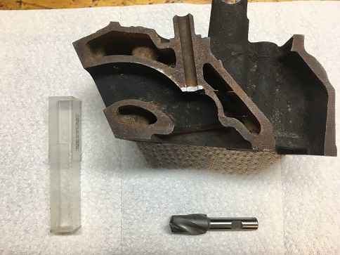

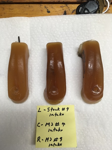

I do have more information on the port shape. Two part RTV resin was used to make the molds, Low durometer rubber for flexability and a good shot of silicone release on the casting prior to pouring in the mix was required to get the molds to release from the port cavity.
The molds were of the intake and exhaust ports of the MJ ported head and a stock 1987 slant head. Compared the two with using caliper measurements and visual inspection. Dimensionally and visually it is obvious there was a lot of bowl work, almost no change in the port arms.
In the bowl itself I found that MJ raised the roof of the bowl .060 to .090 by cutting the inside of the valve guide boss. There was more removed from the intake than from the exhaust.
Photos of the port molds are below.
I did a test where I cleaned up the bowl very much like Mike did, added the 30 multi angle degree intake and 45 degree exhaust seats, and did not raise the roof. The ports flowed about the same as Mikes head until above .350 lift, then it dropped off. I made a fixture to hold the head on my drill press, bought a 3/4 inch end mill and cut the inside valve guide bosses by .070
Re tested the head and the flow came into the range of the MJ ported head across the higher lifts.

PostPosted: Mon Aug 26, 2019 11:13 am
Thanks for sharing this! Looking at the two molds it almost looks as if material may have been added to the short side radius of the intake port just above the seat. Of course I am just spit-ballin' here. Hard to tell from the photo. Interesting stuff none the less. Thanks again for sharing.
P.S. I reckon the larger valve seat would account for the change in shape of the short side radius without any material added there.
PostPosted: Mon Aug 26, 2019 12:10 pm
these is no visible evidence of material being added at the short side radius,
the blend is different because the bowl is physically bigger so the location where the radius joins the bowl is different

PostPosted: Mon Aug 26, 2019 12:12 pm
the blend is different because the bowl is physically bigger,
That makes sense and after thinking about the larger valve bowl I knew that could account for the change in contour. Thanks again.

PostPosted: Tue Aug 27, 2019 11:25 am
additional intake views
notice that on the stock molds, the rubber duplicates the surface profile to the extent that one can see the
sand grain finish from the foundry sand cores used to make the port.
and on the rubber molds from the MJ heads the port surface is generally smooth and slick, so Mike did do some
smoothing of the port walls.
and remember these are stock sized valves in the stock ports and OS valves in the MJ ports, notice how on the MJ ports that the
diameter of the bowl goes right to the diameter of the seat.
The way the intake ports are splayed in slant six heads, the 1,2,3 intakes point one way, the 4,5,6 intakes point the opposite way.
I made a mold of the 3 and 4 MJ intakes to see if there was any difference between the two. I did not see any.
