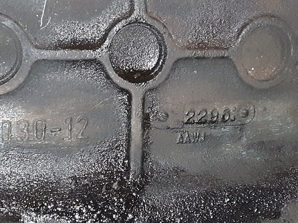

I'm in the process of doing a head gasket/timing job on the old slant six and was trying to figure out what year block/crank i have in my 225? This motor is in my 86 d100 and appears the previous owner swapped it out for an early style engine. These are some of the numbers i found on the block (still scrapping old grease out of the way to find others) so far. It looks like from peaking into the oil pan from the front cover that its a forge crank (thick/long counter weights on the crankshaft).
The numbers on the identification plate right by the coil is 7225R 9 21 2E
drivers side block numbers 030-12 2296
Head numbers 2608 3698447-8

Hello.
Folks on this forum helped me ID my engine, so I feel I should TRY return the favor.
Using Doctor Dodge’s book and the section writing by SlantSixDan, I am coming up with:
1987 model year
225
Regular gas
E = cast-crank
10,000 day calendar
Friday, October 17, 1986
Please correct me if I am wrong—I don’t want to pass bad info
What makes you think it’s older?
Apologize in advance if I’m way off...
