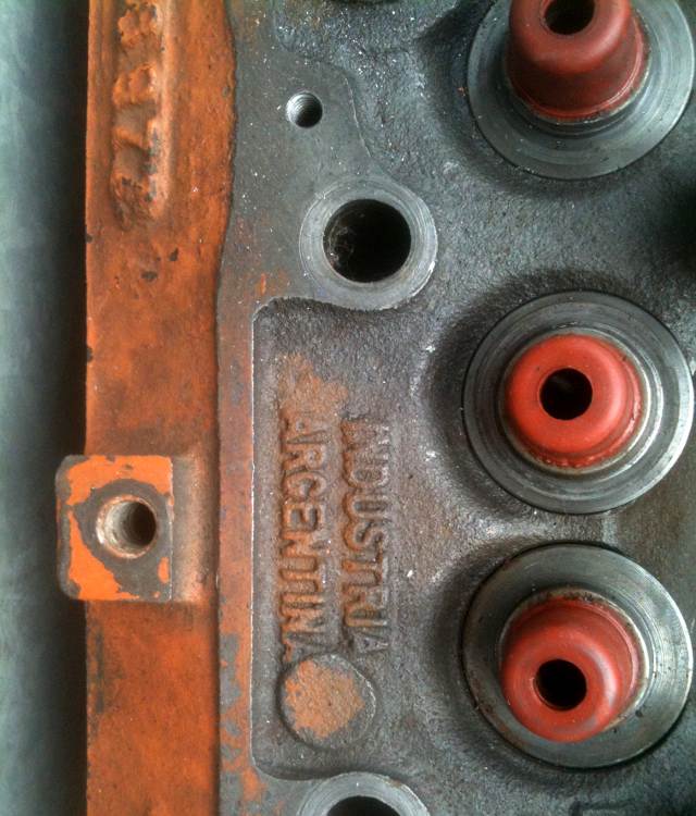

There are two 3/8 -16 unc threaded holes in the top of the cylinder head that are used to lift the engine or engine / transmission, as an assembly.
Use a strap between the two mounting points, when pulling the engine and transmission together. Use just the front mounting point when pulling the engine alone.
