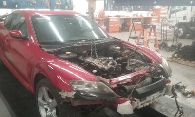

Got the slant pulled out of the 1985 Dodge pickup and dropped it into the RX8. My guess it is a world's first. Sorry for the quality of the pictures. I need a new camera. The slant as you see it is within a half inch on all sides of its final resting place. I need to cut the firewall a little bit, but only after I make a transmission spacer from plywood so that I can build motor mounts. I also need to make some clearance around the steering rack. The hood closes with a couple of inches to spare. Not sure yet if it is quite enough for my idea of LS coils on top of the valve cover.
As for the weight, the slant without starter (don't need it, the Mazda starter is in the transmission) or accessories is 437 pounds. The rotary, with flywheel is 245 (close guess).I removed the oil coolers from the RX8, which saved 20 pounds, and am moving the 40# battery to the trunk. I am also replacing the electric steering rack with hydraulic, which saves 25 pounds.. So I don't think weight is a problem.
I appreciate the good info you guys have given me.
Thank you all for being part of this historic event.

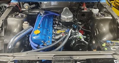

Guess I'm not the only one crazy enough to put one of these where they absolutely don't belong.
Larry

Alright. I got a couple of pictures posted. Seems like it kept giving me a limit of 251kb. Kept resizing in Windows 10. Had limited success.
I am getting ready to swap the RX8 front subframe with a 2006 Miata subframe. I am told that will give me the oil pan clearance I need. I am making plywood bell housing spacers to help mock up motor mounts and make sure I have firewall clearance. I may have to make some changes behind the head into the firewall.
Progress.
