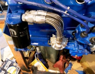

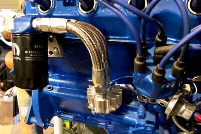

Well guys, here’s my idea of remote filter mount. Not 100% complete, but you get the idea. Thinking of maybe trying some AN fittings, but may just leave it alone.
PostPosted: Sun Jan 15, 2023 4:24 pm
Posts: 9523
Nice set up! I like it. :D
