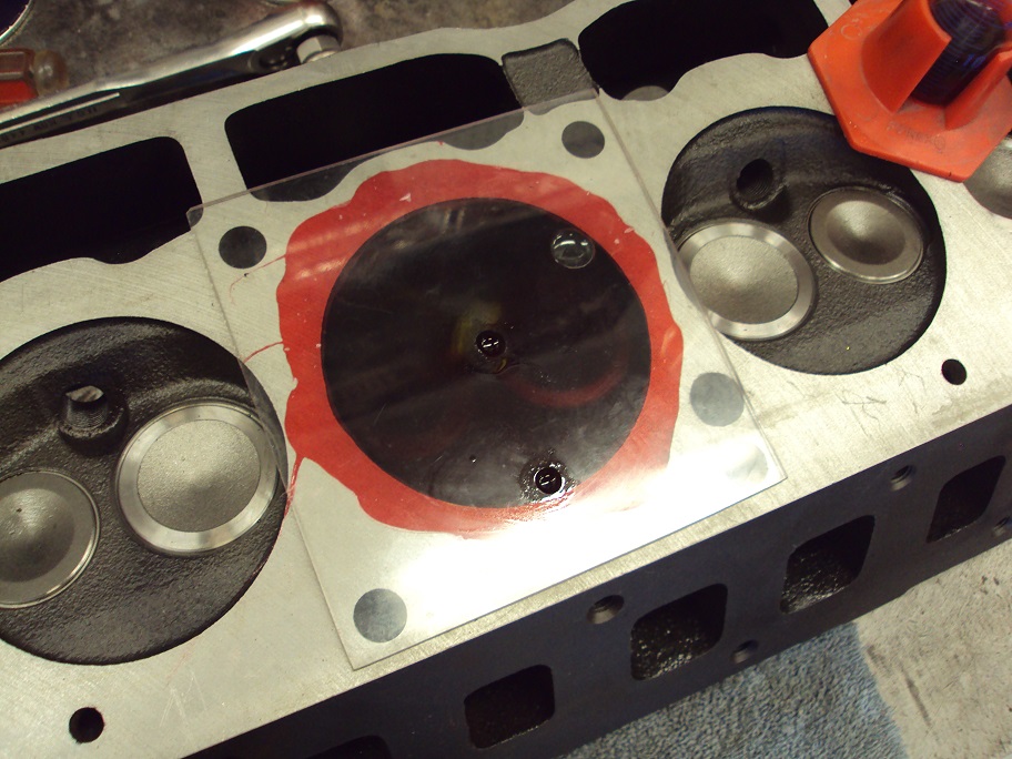

Soooo, Got my head back from my machinist - new stock valves ( back cut @ 25* ), springs, guides, seals and head milled .090". Combustion chambers CC,ed at 48CC's. With stock bore / stroke, .042" compressed gasket thickness, pistons .163" down the hole, I ended up with 8.79:1 CR. I did not run the numbers with stock combustion chambers ( wouldn't hold fluid ), but the CR had to be ridiculously low.

PostPosted: Thu Oct 04, 2018 5:29 pm
Posts: 14849
7.5ish would not be unusual John. Tolerances were very "liberal" from Ma Mopar. :D
Holly Molly! Factory spec is 8.4:1. :? Well, on the plus side, I should still be able to run "tom cat piss" without a detonation problem. :D
