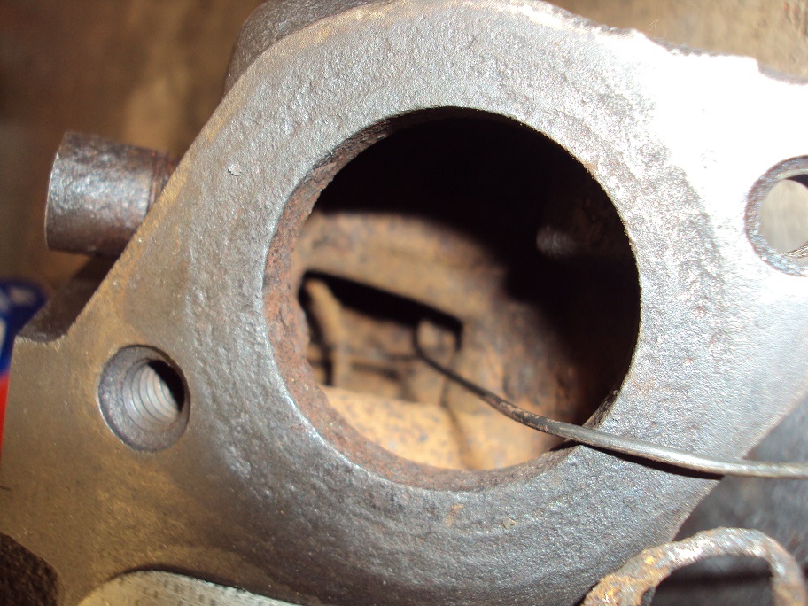

On another note, check out the attached pics. While looking in to the thermostat housing hole I found two lengths of wire in the water jacket. The one I removed ( laying on the head in one pic) came out of the water jacket on the port side of the comb chambers. The other wire is still in the head ( other pic ) and it is on the lifter side of the chambers. Just started to fish it out in that pic. ????????????????? I have no clue as to how they got in there or why.

The wires are part of the casting process. Once casting is complete, the sand is removed, but the wire that holds the sand during the pour remain in place.
