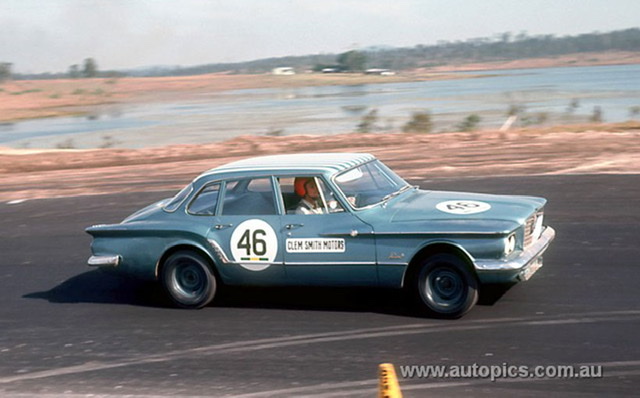

PostPosted: Mon Jan 06, 2020 2:32 pm
Posts: 10246
Looking good.
Whose car is #46?
Weld that cage good and correctly. Lemons sourness checkers seem to be most picky about those bars..
PostPosted: Tue Jan 07, 2020 4:27 am
Posts: 9095
Clem Smith is on the side of the car (from Australia). It was one of several photos Jason sent me when he saw that I was planning to build a Toad.
