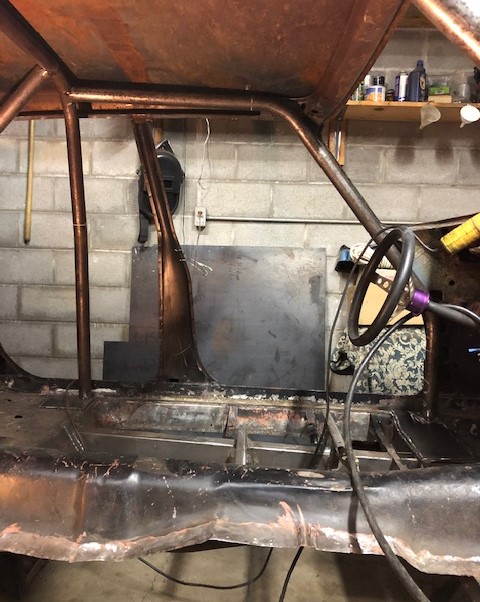

Adam got quite a bit done on the roll cage this weekend.
I cut out some metal and scraped some undercoating...

PostPosted: Mon Jan 06, 2020 2:32 pm

Clem Smith is on the side of the car (from Australia). It was one of several photos Jason sent me when he saw that I was planning to build a Toad.
Adam is taking the cage fabrication very seriously and the boy can weld. :wink:
He has been in regular contact with the main Lemons tech guy concerning the cage.
The tubing is 1.75" DOM rather than 1.50" ERW that we could get away with.

Posts: 1167
Location: Houston, TX
Nice job with the main hoop location. Looks like it lands right on top of the rear subframe crossmember; I wish we'd done ours that way. Ours landed just forward of that, down in the "bathtub" we had to build for the driver's seat. At our first race, Jay made us gusset the main hoop to the rocker panel since he didn't trust our fabrication work.
