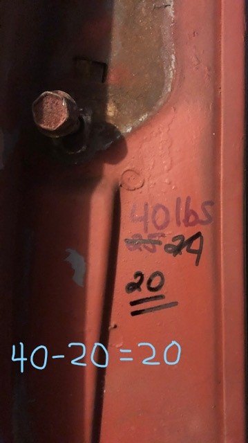

I scraped about a pound or so of undercoating and bondo out of the rear passenger door on ToadRacer.
More to come...

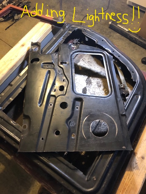

Rear doors went on a diet. :mrgreen:
I ain't the smartest guy on this team... I leave the thinkin' to folks like Adam, Joe & the Perfesser…
I'm better at the simple tasks...

That's 75 lbs off the whole car. That is worth more than 0.1 sec in the 1/4 mile and probably a few tenths off lap times at most courses. Thanks, Rob!!!

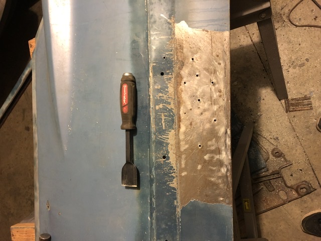

I scraped 5 pounds of undercoating and bondo out of the front passenger door.
That made me decide to go back and get the rest of the bondo off that rear passenger door.
My OCD gets the better of me sometimes...
