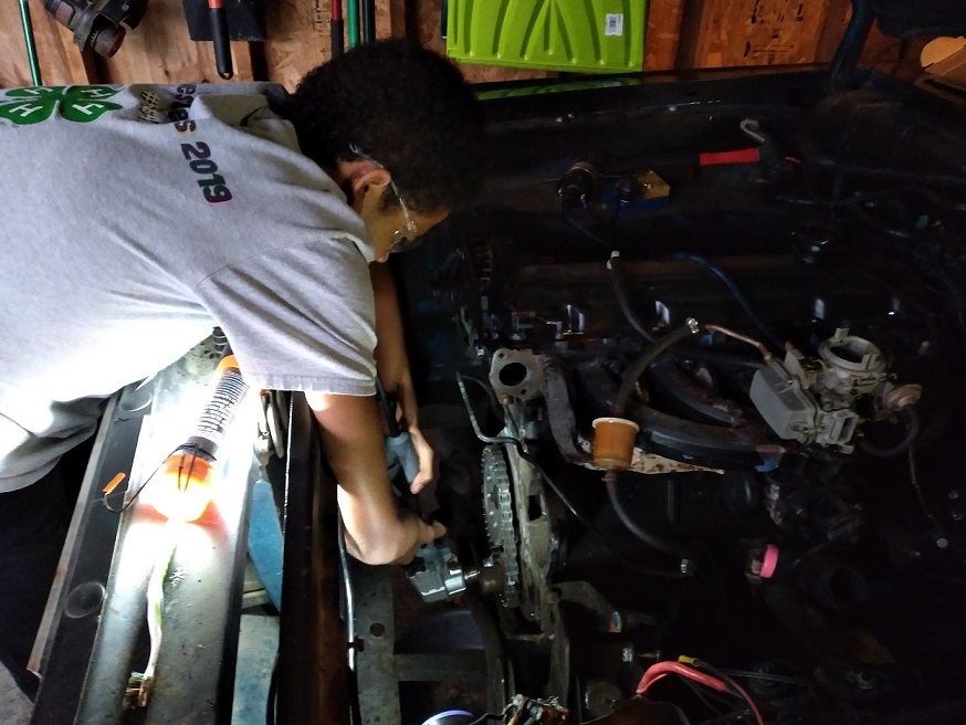

Grandson and I have been working on it every day when he gets home from school. Aside from the motor mounts we've replaced the transmission mount (a gorilla with a 25" breaker bar and a 6' cheater pipe must have tightened the cross-member bolts...lol), and the timing chain and cam gear. No matter what we used we could not get the factory crank gear to come off. We tried heat, various pullers, and a pry bar. So we left it on. Wasn't sure which of the timing marks to use on the front pully assembly as we previously removed the distributor to access a bolt for the motor mount. We pulled the spark plugs, hooked up the battery, and cranked the engine over with my finger in the #1 plug hole. As the compression started to blow past my finger I knew we were close to TDC. We put the timing chain cover on, then slipped on the pulley assembly, and rotated the engine to the next timing mark...TDC!!! According to my old Motors Manual the marks on both gears should be right next to each other, but the cam gear mark was off by 180 degrees. We put it together as it was, dropped in the battery, and she started right up! We figured if it was really 180 degrees off it wouldn't start, and I would pull the distributor and turn the rotor 180, then reinstall it.
We also adjusted the power steering box and got a lot of play out of it. Will have to take it around the block to make sure it will steer ok. Next we will be cleaning the engine and parts so we can put the front of the engine back together.
Chuck
