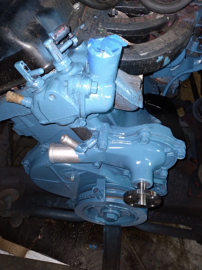

The last week, and today, we got all of the old, probably factory, gasket material from around the timing cover and water pump. That was a lot of work. Wound up using my right-angle drill with a cup brush, and it was slow going. Last Thursday we tried installing the timing cover, but couldn't get the two dowel pins through the holes in the cover. Only way I could figure out how to do it was by dropping the oil pan slightly. Friday my grandson got underneath and loosened the pan bolts about 2 turns. Had to raise the engine a little and remove the driver's side motor mount bracket to access a few of the bolts. Today we were able to drop the front of the pan just enough to seat the timing cover. Then we proceeded to install the new water pump and bypass hose (with worm-style clamps), and the new 180 degree thermostat. Hopefully tomorrow we can repaint the front of the engine Chrysler blue, along with some other areas we can get clean enough.

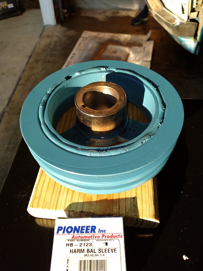

Made some good progress today, I cleaned and painted the left motor mount bracket while Logan was in school. When he got home we did a lot of cleaning and painting, installed the left motor mount bracket, installed a repair sleeve (groove in damper where seal rides) and installed the harmonic damper. A few days ago I detailed the timing mark bracket to easier see the marks.
Tomorrow the carb comes off to replace the leaky carb to intake gasket. Will probably do some cleaning of the intake while the carb is off, and paint it blue.
