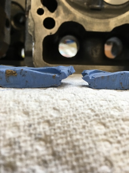

with the cam installed I set the cylinder head on the block, with a used head gasket and checked piston to valve
clearance.
on the intake side the gap gets down to .100 right in the OD of the valve relief.
I believe that is a workable gap. Although that is intake valve shrouding.
So I plan to get in there and buff the valve relief open just a bit.
due to cam timing, plenty of room on the exhaust side.
Used the stock pushrods for this trial. There is a cleanup cut on the block and nothing cut on the head, but the
reground cam has a reduced base circle, I had to crank the adjusters completely in to get the valve lash. A project
for this week is getting a adjustable pushrod made and get pushrods on order.

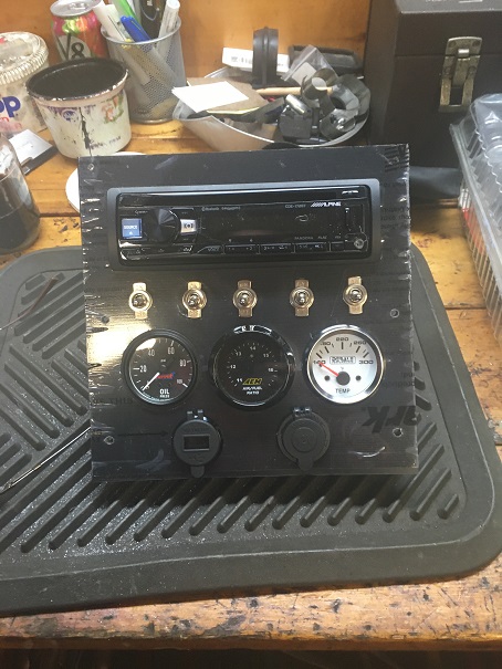

working the wiring, hooked in a battery and ran power to the circuits.
so far so good.
finished the new lower dash gauge mount panel today.
I will build the harness to run power to it over the next few days.
The lower dash panel is an aluminum plate that I had water jet cut to fit the
gauges and radio. The plate cover is plastic laminate that matches the
upper dash.
