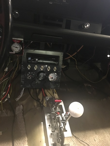

The dash is installed, some of the new under dash wiring is ran, but not all hooked up, the cabin wiring is about done.
The next items are: the under hood wiring, that includes a centralized relay box and to get the valve spring pressure right I need to have the spring seats trimmed, so its
one more visit to the machine shop. Then I can finish assembling the engine and get WV over for an engine install party.

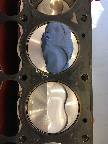

with the cam installed I set the cylinder head on the block, with a used head gasket and checked piston to valve
clearance.
on the intake side the gap gets down to .100 right in the OD of the valve relief.
I believe that is a workable gap. Although that is intake valve shrouding.
So I plan to get in there and buff the valve relief open just a bit.
due to cam timing, plenty of room on the exhaust side.
Used the stock pushrods for this trial. There is a cleanup cut on the block and nothing cut on the head, but the
reground cam has a reduced base circle, I had to crank the adjusters completely in to get the valve lash. A project
for this week is getting a adjustable pushrod made and get pushrods on order.
File comment: pistons with clay

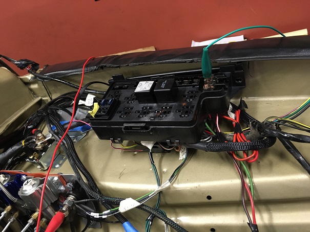

progress on the 68 Barracuda, wiring has been the recent focus, I used a mid 90's Caravan power module when upgrading the circuits on the 83 D150, as I was already familiar with that box I also installed one on the 68 Barracuda, The OE fuse panel remains, however for circuits like headlights and the radio, the OE wiring serves as the trigger for relays in the power module. The power module directs the current flow for the two items mentioned as well as the added electrical components like the MSD ignition, MS3 Pro, electric radiator fans, electric fuel pump and the line locks.
Recent good progress includes the re installation of a delay box. The delay box does not run a trans brake but does control front and rear line locks and also through a relay in the power module integrates into the MS3 Pro to pull ignition timing and or cut cylinder ignition or fuel while the delay timing is engaged.
Photos show the power module and the delay box
Video shows the delay box panel in operation, all the wiring is not fully installed, I like to test prior to the final wrap.

File comment: power module

working the wiring, hooked in a battery and ran power to the circuits.
so far so good.
finished the new lower dash gauge mount panel today.
I will build the harness to run power to it over the next few days.
The lower dash panel is an aluminum plate that I had water jet cut to fit the
gauges and radio. The plate cover is plastic laminate that matches the
upper dash.
